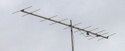

So are you saying you ar getting KNRR Pembina? Chould you post a picture of your antenna and did you make it yourself? I am in the NE of Wpg, have been waiting to test anything.

As per request, here is a image of the antenna I am using;
These are a familiar sight to those who live in Manitoba. There was once a time when a lot of people were keen to receive KCND on channel 12 (http://en.wikipedia.org/wiki/KCND-TV). They are still found on the occasional roof (usually with a bit of rotted twin lead). I suspect that there are a lot of these still to be found on the rafters of garages and could be obtained for the trouble of asking.
I have seen signal quality ranging from 48% (unusable) to 62% so far from KNRR here in the west end of Winnipeg. When it is good and the signal source is from the network the quality is excellent (speaking in SD terms). I still see a glitch from time to time even at the best signal quality seen. I now suspect impulse noise as previously experienced with the analog signal. The variation of signal quality was pretty much par for the course for the previous analog version. You still can see dual phased high gain channel 12 antennas on houses around Winnipeg on 30 foot pop up masts so i am guessing that there have always been bad days for this particular signal. Reliable reception of KCND was a big selling point for the earliest cable system in Winnipeg...

bwalzer, is it just me, or are you missing a director near the front of the antenna? The spacing between them seems odd.
