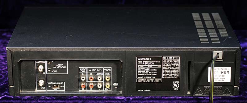

Ok here's where I am.
Have a 605 that needs to go to TV1 using component connections. It also needs to go to TV2 using coax. I have this VCR:
Can I do it, or do I need a different solution?
Connect the 605 with composite red/white/yellow to the input of your VCR. Coax out to TV2 coax in. You will need to find the proper video channel that the VCR uses for composite such as Video 1 or Video 2 (check the VCR manual). Leave the VCR on that channel.

Thanks guys, I got it. I had to change the input, everything else I had hooked up already, with the addition of the audio cables from the VCR to TV1. Luckily I found the remote.
