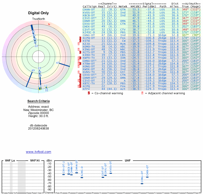

hi. I am new to the OTA however I have been doing some reading on the issues and I want to thank everyone for your help so far. I live on the 3rd floor of a 4 story walk up (no balcony) and I face in a southerly direction. My tuner in the TV does not pull any stations so I bought a Phillips SDV86227/27 Indoor/Outdoor antenna to get the ball rolling. I can pull in:
CHEK 6.1
MeTV 12.1,
Cool TV 12.2
KBCB 24.1
KBCB2 24.2
KBCB3 24.3
KBTC 28.1
WLD 28.2
TVW 28.3
So I feel fortunate and I have moved it around a bit and I can sometimes pick up CBC and JoyTV. How do I pick up more local stations? Different antenna? see if the building will let me put it on the roof? my TVFool says I should be able to pull the following http://www.tvfool.com/modeling/tmp/e...getdigital.php
Your input please.
tagdude is offline
Old 2012-08-30, 01:27 PM   #493
Ndnile
Join Date: Jun 2011
Location: Victoria BC - shelbourne
Posts: 273
Default
Have you had any luck aiming your antenna north you should be able to get some from mount seymour you might need an antenna with higher net gain.
