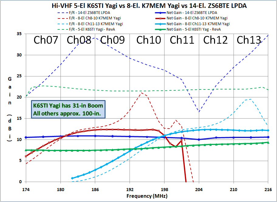

I modeled and compared several DIY Hi-VHF Antennas here:
http://imageevent.com/holl_ands/yagis
Comparison charts are included in K6STI results:
http://imageevent.com/holl_ands/yagis/k6sti

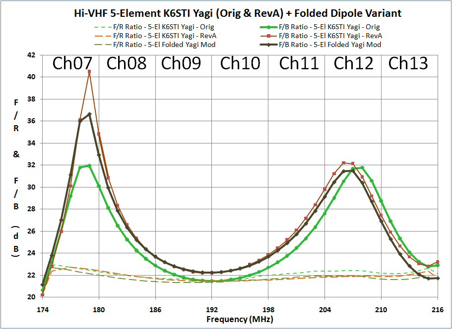

DIY K6STI's 5-ELEMENT YAGI:
Optimized for best F/R Ratio on Ch7-13, and has a F/B Ratio that is even higher than
the charted F/R Ratio (see chart below).
Shrinking all sizes by a factor of about 0.94 (seat of pants guestimate, not modeled)
would move the F/R Ratio peak so that it falls on top of Ch13.

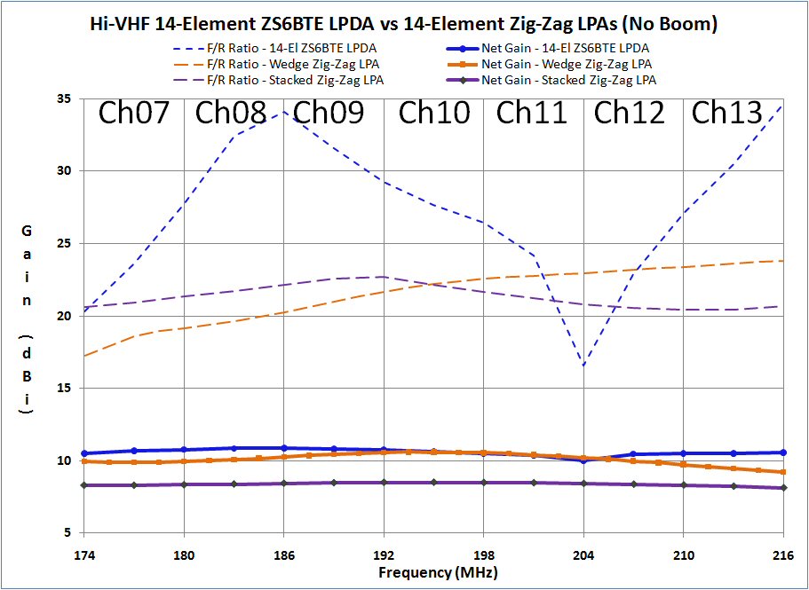

DIY ZS6BTE's 14-ELEMENT LPDA:
Exhibited an even higher F/B Ratio (equal to F/R Ratio) on Ch13:
http://imageevent.com/holl_ands/zigzaglpa/lpda/lpda14el
My DIY WEDGE ZIG-ZAG LPDA:
Simple DIY design for attic use also had high F/B and F/R Ratios:
http://imageevent.com/holl_ands/zigzaglpa/zigzagnoboom
